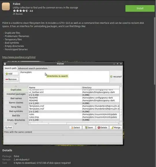

FSLINT
you can also use fslint from grafphical user interface that is available till ubuntu 18.04 because now the use of fslint in 20.04 is not possible as standard because python2 is not present as it is deprecated.
sudo apt install fslint
For the use fslint
