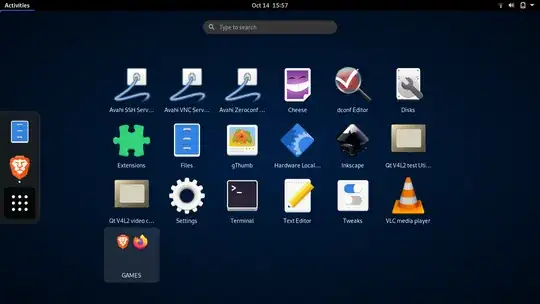

You should give it a name and put atleast one desktop file name followed by your first command..
An example:
[admin@ADMIN ~]$ gsettings set org.gnome.desktop.app-folders folder-children "['Games']"
[admin@ADMIN ~]$ gsettings set org.gnome.desktop.app-folders.folder:/org/gnome/desktop/app-folders/folders/Games/ name 'GAMES'
[admin@ADMIN ~]$ gsettings set org.gnome.desktop.app-folders.folder:/org/gnome/desktop/app-folders/folders/Games/ apps "['brave-browser.desktop', 'firefox.desktop']"
[admin@ADMIN ~]$
Once the above commands are ran, you must restart the gnome-shell or login back.. to see the changes..
Observe that the first one you gave Games is for Identification purpose and the actual one in the second command sets the name that shows in ShowApps/AllApps
