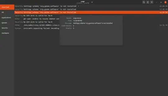

It's mentioned in the logs that
Settings schema 'org.gnome.software' is not installed
Logs screenshot
I was kinda confused/worried after reading this log because it was under 'Important' category and comes under 'Security'. Why is it under 'Important' category and comes under 'Security'?

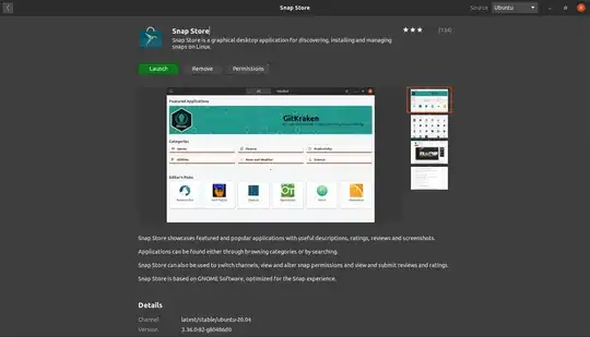

Then the Snap Store app was shown in the "Show Applications".
Snap Store app icon

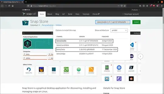

The version of snap-store before uninstalling it was 3.36.0-82-g80486d0 (beta version). The version of snap-store after installing it again is 3.31.1+git187.84b64e0b (stable version).
Snap Store website screenshot Screenshot taken (on 13th October, 2020) from https://snapcraft.io/snap-store

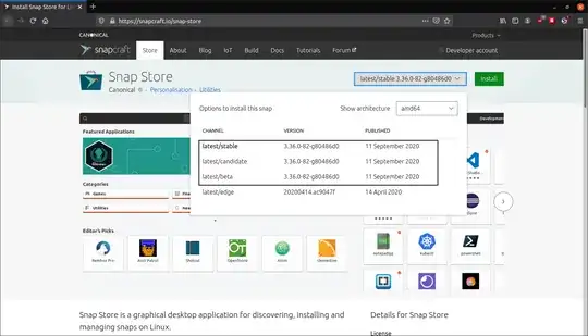

Snap Store website screenshot as on 23rd October 2020 Screenshot taken (on 23rd October,2020) from https://snapcraft.io/snap-store
But the weird thing is, most of the channels (stable, beta and candidate) have the same version number in the website. But since I didn't mess up with any snap-store stuff, I hope I'm in stable channel.
