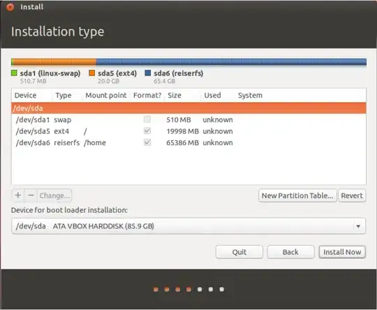

You can reinstall Ubuntu without erase your personal data (the one in the /home). I assume that you create different partitions in your system for:
  • /home
  • swap (optional)
  • root/
If you did that, then when you ask to select partitions in your install settings window, you check "format" only in root partition. Doing that, you keep your old files in /home partition (You still have to select the partition as mount point for /home, but without format it).
Example of partitions with different mount points
