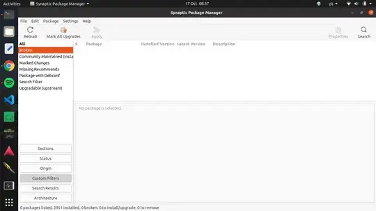

Unable to correct problems, you have held broken packages has been recommended to me, but there dpkg --get-selections | grep hold returns nothing and there are no broken packages in synaptic:
