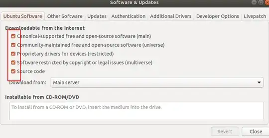

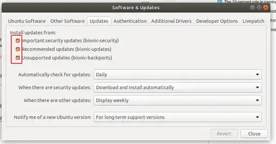

I am able to install gcc. I am not sure what exact problem but enabling all packages from software & updates resolved the issue, It might help someone.
$ gcc --version
gcc (Ubuntu 8.4.0-1ubuntu1~18.04) 8.4.0
Copyright (C) 2018 Free Software Foundation, Inc.
This is free software; see the source for copying conditions.  There is NO
warranty; not even for MERCHANTABILITY or FITNESS FOR A PARTICULAR PURPOSE.
I have enabled all the software packages from software & updates. software & update > Ubuntu software tab
Also enabled security update enter image description here
