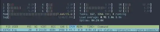

UPDATE: Htop screenshot
UPDATE 2:
htop screenshot CPU usage high
This shows the CPU usage on its way to 100%, and I found out that this behavior only happens in a specific git repository once I cd in it. I've run git status with some flags and it is using 100% CPU. But the diff is really small. Other git repos in my machine work fine.
