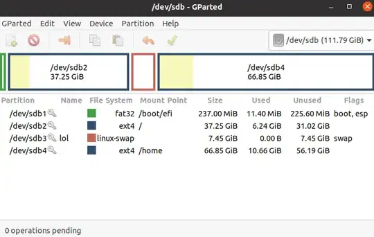

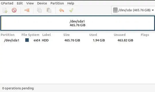

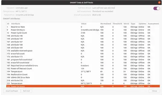

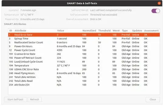

Screenshots from GParted and Disks (SMART):
01_disks_smart_SSD
02_disks_smart_SSD
disks_smart_HDD
gparted_sda
gparted_sdb

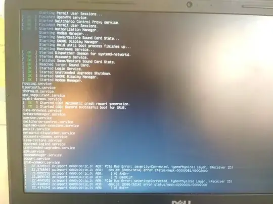

Messages shown when hitting Esc at boot:
messages shown when hitting ESC at boot

You have AER (Advanced Error Reporting) errors on your wireless or ethernet interfaces. If this is a desktop computer, re-seat the wireless card and the ethernet card... otherwise do this...
sudo -H gedit /etc/default/grub # edit this file
Find:
GRUB_CMDLINE_LINUX_DEFAULT="quiet splash"
Change it to:
GRUB_CMDLINE_LINUX_DEFAULT="quiet splash pci=noaer"
sudo update-grub # update GRUB
reboot # reboot the computer
