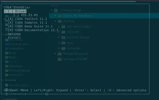

I think the issue is the CUDA driver version. It looks like the installer tries to install the newest version 455.23.05 and the installation actually fails there.
I've solved it by first downloading the local installer and unselecting the CUDA driver installation, so it just installs the toolkit.
wget https://developer.download.nvidia.com/compute/cuda/11.1.0/local_installers/cuda_11.1.0_455.23.05_linux.run
chmod +x cuda_11.1.0_455.23.05_linux.run
sudo ./cuda_11.1.0_455.23.05_linux.run
In the menu unselect the driver installation: enter image description here If not already done, add the nvidia repo as per instructions from the official website before installing the driver:
