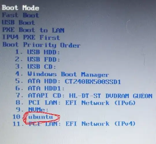

I had installed in the dual boot along with windows 10. Now, i want to install parrot os in the dual boot along with windows 10. In order to do that, i deleted the partition where i had installed ubuntu. After that, i removed ubuntu from the grub boot menu using the following methods.
Do I need to remove "Ubuntu" from the boot menu after removing dual boot?

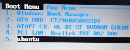

After this, i was expecting that it should be removed from the grub boot menu. Again i opened boot menu and i got this.. enter image description here

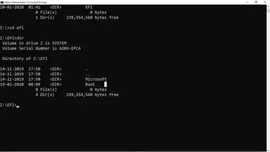

Again when i follow the same approach to see if there is ubuntu in the grub menu or not. Then i got this.
enter image description here You can see,there is no option for ubuntu.
You can see, still there is ubuntu in boot menu. enter image description here

As PonJar said, i pressed the delete button in the first picture instead of 2nd picture. Then a cross sign appears on the left side on ubuntu.Then i restarted and everything works.
