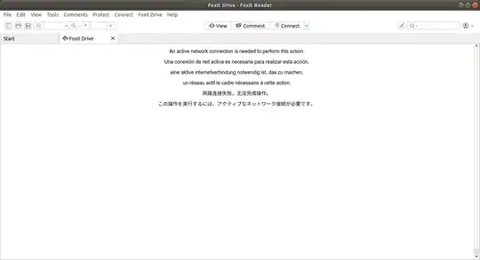

I have recently installed Foxit Reader following this post. In Foxit Reader internet doesn't seem to work.
When I open Foxit Drive I get the following network error:
network error in Foxit Reader

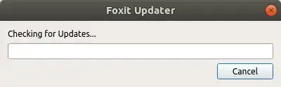

When I click on the Check for updates button the progress bar doesn't move at all :
No progress while checking for updates

This issue is not related to your network settings at all.
Some time ago, Foxit retired the Foxit Drive service. Multiple websites report that there was a notice some time ago that the Drive service and plugin in Foxit would be retired and should not be used.
What that windows is reporting is the Foxit Drive plugin says you have no network connection, when in reality the problem is that Foxit Drive is just dead and gone and no longer available upstream. The corresponding Foxit Drive plugin is the problem and is still present in this third-party binary.
Unfortunately, there's no way to disable the Foxit Drive plugin, nor is there a way for us or anyone else to fix the problem. You need to open a ticket with Foxit to tell them to remove the Foxit Drive plugin. Until they release an update that removes Foxit Drive from the equation, it will still continue to give you those errors. Basically, don't use the Drive plugins at all or try to use Foxit Drive which is dead.
