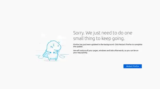

For a little background (because I was shocked to know this user has never seen this before), whenever firefox updates in the background, every new tab looks like the attachment here. You can't get a working tab until you restart firefox... which is EXTREMELY annoying/intrusive especially when you have a dozen or so tabs open that you are actually using.

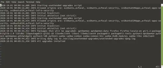

Because I was working with someone else with this in the evening, I was paying close attention. My firefox version was 80.0.1 last night. Same thing JUST happened on a different machine, I got the You Will Restart Now and Like It tab seen above. I restarted and now I have version 81. Being that I DEFINITELY know I didn't get a Software Updater popup, I started checking into unattended-upgrades.... and what do you know... (after all of these years) According to this /var/log/unattended-upgrades/unattended-upgrades.log, firefox is actually an unattended-upgrade(which i did not believe).
Knowing this now, @N0rbert's answer will definitely probably help this, but I want to only kill the unattended-upgrades for firefox. So I will now shift to figuring that part out. I'm still a little baffled that some firefox users have never seen this. Makes me think there is a little more to it or that it is common practice to turn off unattended-upgrades??? will update.

  4. In my case, the cause was most likely due to unattended-upgrades, as shown by
    $ grep firefox /var/log/unattended-upgrades/unattended-upgrades.log, which outputs: 2023-06-07 06:30:37,195 INFO Packages that will be upgraded: firefox ...
