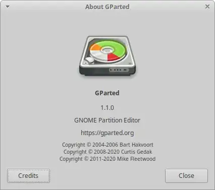

Now gparted should show the newest version:
