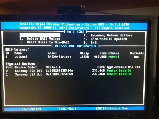

[Additional info] I have two SSDs configured as RAID 0 with Intel RST. On that RAID, I have both Windows 10 and Ubuntu 20.04. See pic below. In the UEFI BIOS, Sata mode selection is set to RAID, no AHCI. Intel RAID config
