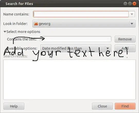

Install gnome-search-tool.
sudo apt-get install gnome-search-tool
Open Search for files select Select More Options and
