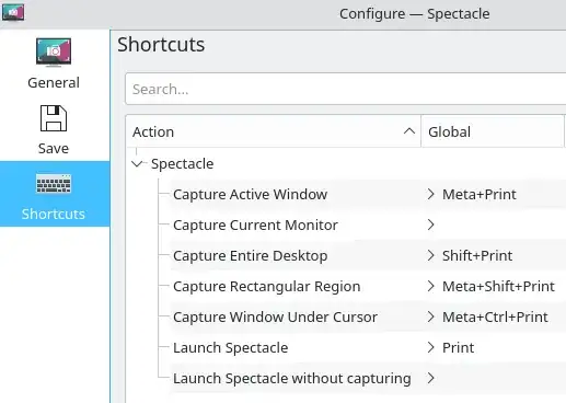

You can run the program called spectacle.
In case you have to install it manually, just type the following command in your terminal and follow the instructions:
sudo apt install kde-spectacle
This is what it looks like in KDE Plasma V5.27 as of 2024: enter image description here

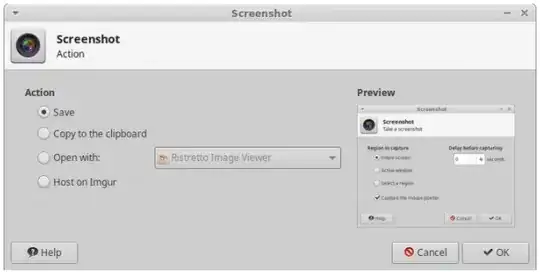

Apart from Spectacle there's also xfce4-screenshooter which has the option Host on Imgur:
