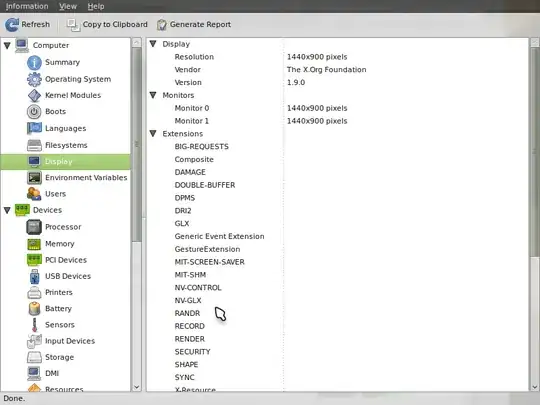

If you want you can also install hardinfo Install hardinfo on your system, and when you launch it (system benchmark and profiler in the system menu), you can find your graphics information easily.
Example
See this image for an example.
