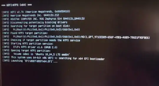

That basically said to go to my efi partition and there deleted the ubuntu directory. It worked and when I boot my laptop it runs Windows 10. Then I installed Ubuntu 18.04LTS on a virtual machine, but again, for school reasons, I need native Ubuntu 18.04LTS on my laptop. So I made a stick with Ubuntu 18.04LTS (using Rufus) and tried to install it, but when I boot the stick, it shows me this:
and then takes me to the gnu grub prompt. And I don't know what to do. Windows 10 works just fine. I guess maybe I need to create another directory similar to the one I deleted before..? I appreciate your help.
