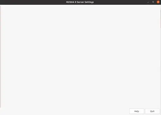

Everything was fine until a few days ago I suddenly got the following error when executing nvidia-smi:
NVIDIA-SMI has failed because it couldn't communicate with the NVIDIA driver. Make sure that the latest NVIDIA driver is installed and running.
Since then, I couldn't properly open my NVIDIA X Server GUI, as attached: enter image description here

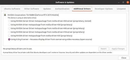

When checked out Software & Update, I found out the driver strangely fell back to Nouveau display driver (as attached): nvid

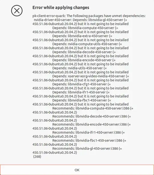

I couldn't switch back to NVIDIA driver listed above. Whenever I attempted to switch, I got the following error:

Error when installing nvidia-driver-450-server
sudo apt-get install nvidia-driver-450-server
Reading package lists... Done Building dependency tree
Reading state information... Done Some packages could not be installed. This may mean that you have requested an impossible situation or if you are using the unstable distribution that some required packages have not yet been created or been moved out of Incoming. The following information may help to resolve the situation:
The following packages have unmet dependencies: nvidia-driver-450-server : Depends: libnvidia-gl-450-server (= 450.51.06-0ubuntu0.20.04.2) but it is not going to be installed Depends: libnvidia-compute-450-server (= 450.51.06-0ubuntu0.20.04.2) but it is not going to be installed Depends: libnvidia-extra-450-server (= 450.51.06-0ubuntu0.20.04.2) but it is not going to be installed Depends: nvidia-compute-utils-450-server (= 450.51.06-0ubuntu0.20.04.2) but it is not going to be installed Depends: libnvidia-decode-450-server (= 450.51.06-0ubuntu0.20.04.2) but it is not going to be installed Depends: libnvidia-encode-450-server (= 450.51.06-0ubuntu0.20.04.2) but it is not going to be installed Depends: nvidia-utils-450-server (= 450.51.06-0ubuntu0.20.04.2) but it is not going to be installed Depends: xserver-xorg-video-nvidia-450-server (= 450.51.06-0ubuntu0.20.04.2) but it is not going to be installed Depends: libnvidia-cfg1-450-server (= 450.51.06-0ubuntu0.20.04.2) but it is not going to be installed Depends: libnvidia-ifr1-450-server (= 450.51.06-0ubuntu0.20.04.2) but it is not going to be installed Depends: libnvidia-fbc1-450-server (= 450.51.06-0ubuntu0.20.04.2) but it is not going to be installed Recommends: libnvidia-compute-450-server:i386 (= 450.51.06-0ubuntu0.20.04.2) Recommends: libnvidia-decode-450-server:i386 (= 450.51.06-0ubuntu0.20.04.2) Recommends: libnvidia-encode-450-server:i386 (= 450.51.06-0ubuntu0.20.04.2) Recommends: libnvidia-ifr1-450-server:i386 (= 450.51.06-0ubuntu0.20.04.2) Recommends: libnvidia-fbc1-450-server:i386 (= 450.51.06-0ubuntu0.20.04.2) Recommends: libnvidia-gl-450-server:i386 (= 450.51.06-0ubuntu0.20.04.2) E: Unable to correct problems, you have held broken packages.

As a temporary solution, try to boot the previous kernel version if everything was okay previously. In my case, the working kernel was 5.4.0-47 (*-48 was broken). Hopefully, it is some temporary issue with package dependencies which will be resolved soon.
Update: I have fixed the issue with the new kernel version (5.4.0-48) by aptitude install nvidia-driver-450. There was a lot of warnings about some conflicts and removing of nvidia-*-440 packages, but finally the new version installed and the new kernel boots with nvidia drivers and everything looks good so far.
I finally found a fix to the exact same problem. Boot back into the faulty 5.4.0.48 kernel. Now, open your terminal and do the following:
  1. Run:
    sudo apt-get dist-upgrade
  2. Open Software Updater and install the new updates.
  3. Reboot and the NVIDIA driver should work again.
