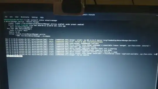

And lastly I would like to say that I have noticed that internet works just fine when I login in single user mode(recovery) but in tty and console it doesn't! I tried the solution mentioned in this question also but it didn't work Cannot Login to 14.10 GUI
PS Sorry but, I am on my phone and I cannot type out all the output and I couldn't take screenshots so using images please help!

This may be a late reply, but have you tried adding nameservers manually I had the same issue when installing Docker and I solved it by adding editing resolv.conf file and adding the following nameservers manually.
sudo nano /etc/resolv.conf
add
nameserver 8.8.8.8
nameserver 8.8.4.4
