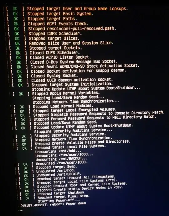

My computer suddenly won't shutdown or suspend anymore. Disks power down, but the computer won't. I have to shut down the computer by holding the power button.
The shutdown process ends with a "reboot: Power down" message, but nothing happens:
And it just stays like that. It used to work fine. The only thing I remember doing is running BootRepair a few days before because an update messed up booting. But I believe I may have shut down with no issues at some point after that.
Rebooting shows a similar message ("reboot: Restarting system") but after around 15 seconds, it does eventually reboot.
