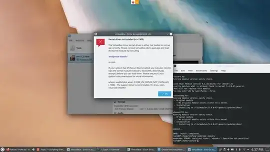

VirtualBox does not want to run VMs. It says the kernel driver is not installed. I reinstalled the virtualbox-dkms package and ran 'modprobe vboxdrv' as root but it still doesn't work.

You need to disable Secure Boot in UEFI (aka BIOS) settings as it is mentioned in the error message.
