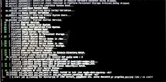

This is the point where my laptop freezes:

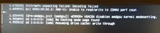

And this might be my main problem:

I had the same problem as you. I finally could boot KALI distro (in live first, then installing it completely). To do that, I changed manually in the GRUB.CFG file the boot options, adding the following ones:
noeject noautomount acpiphp.disable=1 pcie_aspm=off nvme_core.default_ps_max_latency_us=14000
It worked!
I need to thank all the users of various forum who gave some piece of information.
What I understood is that the specific model of SSD Drive (a Western Digital SSD drive) was not recognized.
