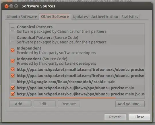

Edit: in response to Mike's answer, I'm posting a couple of screenshots: Ubuntu Software Others
Second edit: I'm including my present /etc/apt/sources.list. This is after I unticked the "source code" entry which was previously ticked in the "other software" image.

I disabled apt.conf's deb-src lines per mikewhatever's answer. This brought it down, as with you, to ~6MB.

Perhaps the difference is the source packages. Try disabling them in the Software Sources window, or else, edit /etc/apt/sources.list, and comment out lines that start with deb-src, ...that is, if you don't need the source code.
