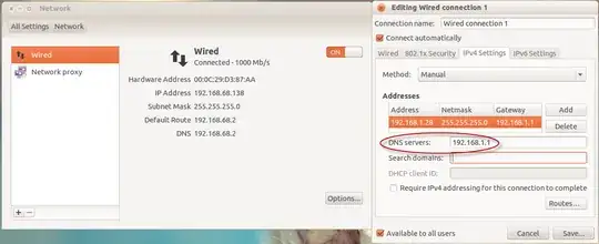

Are you sure that you provided 192.168.1.1 as the value for the DNS when you set up the static IP?
I don't know how to do this from the command line, but using the System Settings -> Network GUI should work too, no? All I'm thinking is that you want something like the screen capture below? Or am I not understanding what you are trying to do?
Network config with static IP, default route, DNS server
Note: Ignore the values in the left-hand window. Those are just my values from DHCP. I didn't bother to save the static config since I was just trying to illustrate what I was thinking.
By the way, I used 192.168.1.1 because that's what you were using. But you could also use the IPs for any valid DNS servers. For example, 8.8.8.8 and/or 208.67.222.222 should also work.
