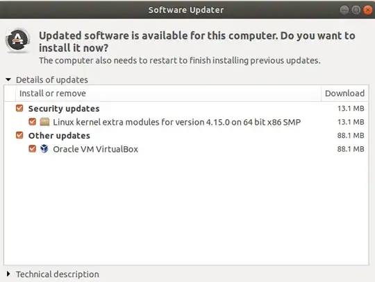

I downloaded the latest version of Virtualbox from Oracle website and installed it on my Ubuntu 18.04. It all went well until at the end when I had a few warnings about broken packages etc. Didn't get round to using it even though it launched fine and was ready to go. Later on I updated the system and I needed to reboot. Bootloader gave me three new options none of which made any sense to me. I ignored them and clicked on the fourth option of "continue to boot". A red notification warning appeared at the top right of the screen. Guessing it was all related to Virtualbox I deleted/removed/purged it. The warning disappeared. Now everytime I want to do a system update it says it wants to install Virtualbox -- it says it is already downloaded!

Running this should purge the remnants of Virtualbox:
sudo apt purge unity-scope-virtualbox virtualbox-6.1
