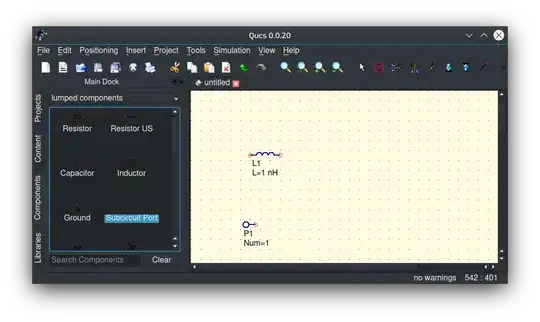

I`m trying to install Quite Universal Circuit Simulator from source code and get error:
configure: error: Qt >= 4.6.0 is required.
configure: error: ./configure failed for qucs

Although @kyodake answer is correct, there is good news:
  1. Nice developers are working on Qt5 port in the main site;
  2. I have concocted an AppImage version (alas, without manuals and probably not the best configured one, but it works) here: https://rmano.github.io/qucsAppImagesBuild/
You can just download the AppImage, make it executable with chmod +x, and run it.
