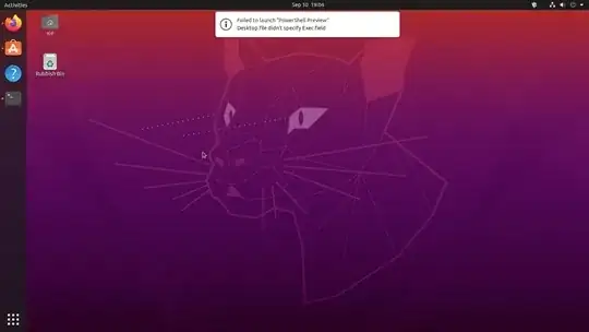

I am having trouble installing PowerShell 7 on Ubuntu 20.04. I used Ubuntu Software to install powershell 7.0.3, which is the latest/stable version available. After an error-free installation, I cannot launch powershell. Attached is the screenshot. I couldn't find the documentation on the desktop file supposed to specify exec field. I note that v7 is "PowerShell Preview". Does it mean that I should install v6 instead? If so, how to get the version?
$ uname -r
5.4.0-47-generic
Screenshot of the error message
