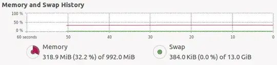

Live CD Boot enter image description here
ubuntu@ubuntu:~$ free
             total       used       free     shared    buffers     cached
Mem:       1015780     983500      32280          0      87408     558984
-/+ buffers/cache:     337108     678672
Swap:     13590952        384   13590568

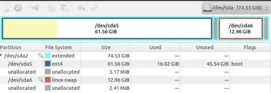

Output of sudo fdisk -l
Disk /dev/sda: 80.0 GB, 80026361856 bytes
240 heads, 63 sectors/track, 10337 cylinders
Units = cylinders of 15120 * 512 = 7741440 bytes
Sector size (logical/physical): 512 bytes / 512 bytes
I/O size (minimum/optimal): 512 bytes / 512 bytes
Disk identifier: 0x2bd2c32a
   Device Boot      Start         End      Blocks   Id  System
/dev/sda2               1       10338    78149632    5  Extended
/dev/sda5   *           1        8539    64551936   83  Linux
/dev/sda6            8540       10338    13590958+  82  Linux swap / Solaris

Gparted Screenshot: enter image description here
