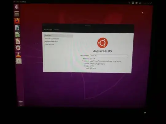

After updating Ubuntu to 20.04 but is showing Unity. Before 20.04, I had 18.04 upgraded from 16.04 but that also had same desktop environment.
Unity on 20.04
How can I switch to Ubuntu's default GNOME based desktop environment?
