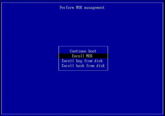

Also if you have a third-party driver(e.g. Nvidia) you should reinstall the driver and then, a pop-up window will be displayed asking for a password for enrolling key on the next reboot:
Then reboot the system and immediately after reboot you will see something like this:
Select Enroll MOK and then enter the password that you set before.
