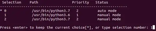

I tried this solution but I am also unable to open Software and updates.
Ubuntovative is here
  • 1,162
  • 15
  • 41
I could finally solve the problem myself. Before that, I did sudo update-alternatives --config python3 and switched to python 3.6 python version change After that, I followed the answer of the same post (which I couldn't earlier because Software and updates wouldn't open) and unticked https://dl.bintray.com/aluxian/deb. Then the sudo apt-get update problem was solved !!!
