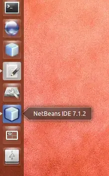

I created a netbeans.desktop and eclipse.desktop and added them to Unity launcher and did exactly the same for eclipse & Netbeans here: How do I install Eclipse Indigo 3.7.1? in order to run it from terminal or dashboard. The problem is that if I run them from dashboard or terminal, another entry is displayed in the launcher.
second Entry in Launcher
Is there any solution so that when I run the IDEs from dashboard or terminal, only the Launcher entry already pinned, is used?

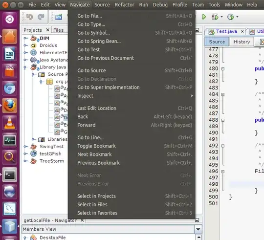

Effective solution found thanks to Java Swing Ayatana library.
Netbeans Integration with Global Menu and Launcher
Open your Netbeans IDE, then go to menu: Options / Plugins; And add the Java Ayatana plugin's remote XML catalog file: http://java-swing-ayatana.googlecode.com/files/netbeans-catalog.xml and then install it - (Restart NetBeans).
