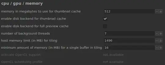

I have a Thinkpad T495 with AMD 3500 PRO:
$ lspci | grep VGA
06:00.0 VGA compatible controller: Advanced Micro Devices, Inc. [AMD/ATI] Picasso (rev d2)
Using clinfo command I can see that the platform has an OpenCL profile:
$ clinfo
Number of platforms                               1
  Platform Name                                   AMD Accelerated Parallel Processing
  Platform Vendor                                 Advanced Micro Devices, Inc.
  Platform Version                                OpenCL 2.0 AMD-APP (3182.0)
  Platform Profile                                FULL_PROFILE
  Platform Extensions                             cl_khr_icd cl_amd_event_callback
  Platform Extensions function suffix             AMD
Platform Name AMD Accelerated Parallel Processing Number of devices 0
NULL platform behavior clGetPlatformInfo(NULL, CL_PLATFORM_NAME, ...) No platform clGetDeviceIDs(NULL, CL_DEVICE_TYPE_ALL, ...) No platform clCreateContext(NULL, ...) [default] No platform clCreateContext(NULL, ...) [other] No platform clCreateContextFromType(NULL, CL_DEVICE_TYPE_DEFAULT) No devices found in platform clCreateContextFromType(NULL, CL_DEVICE_TYPE_CPU) No devices found in platform clCreateContextFromType(NULL, CL_DEVICE_TYPE_GPU) No devices found in platform clCreateContextFromType(NULL, CL_DEVICE_TYPE_ACCELERATOR) No devices found in platform clCreateContextFromType(NULL, CL_DEVICE_TYPE_CUSTOM) No devices found in platform clCreateContextFromType(NULL, CL_DEVICE_TYPE_ALL) No devices found in platform
I tried install amdgpu-pro, but the installation failed with this error
Unpacking amdgpu-dkms-firmware (1:5.6.0.15-1098277) ...
dpkg: error processing archive /var/opt/amdgpu-pro-local/./amdgpu-dkms-firmware_5.6.0.15-1098277_all.deb (--unpack):
 trying to overwrite '/usr/share/doc/amdgpu-dkms-firmware/LICENSE', which is also in package rock-dkms-firmware 1:3.7-20
dpkg-deb: error: paste subprocess was killed by signal (Broken pipe)
Errors were encountered while processing:
E: Sub-process /usr/bin/dpkg returned an error code (1)
Still when I open Darktable, OpenCL option is not supported: Darktable screenshot
Shadi
  • 141
I know this is an old query...but do you have the snap installed? If so remove it and install the official PPA. https://software.opensuse.org/download.html?project=graphics:darktable&package=darktable Thanks
