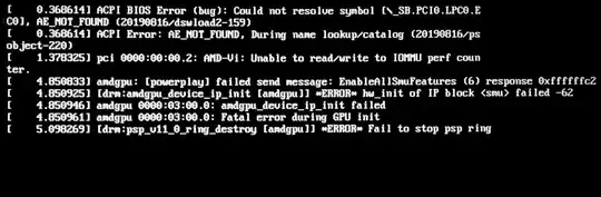

I have a Dell G5 SE with an AMD GPU and CPU. I'm trying to dual boot Ubuntu 20.04.1 with Windows 10 from a USB drive. When I boot from the drive, the grub screen pops up and shows a few options. After a few seconds, it seems like it tries to run Ubuntu, but runs into problems.
ACPI BIOS error (bug): Could not resolve symbol [_SB.PC10.LPC0.EC0]
AE_NOT_FOUND (20190816/dswload2-159)

fninser
When booting from usb drive, the grub menu is dsplayed. So, press "e" to enter edit mode. Then add "acpi=off" after "quiet splash"
