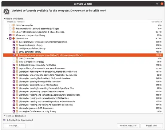

Running 20.04, the software updater shows several updates which are not selected to install by default, and which I cannot choose to install: clicking on them does nothing. Please see the image below. Several questions:
  • Why is this happening?
  • Did I do something wrong? (And if so, what?)
  • Is there something I should do now?

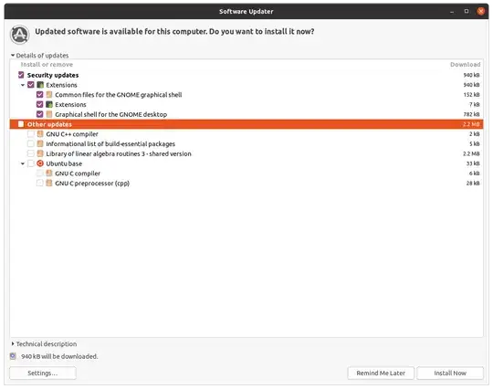

A few days later, I get this update:

What I'm seeing appears to be what happens when this is the situation: The following packages have been kept back
There is an extended discussion, but in summary, it should resolve itself in time.
