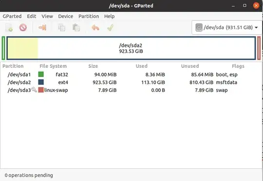

  1. Run gparted on a terminal (press Ctl-Alt-t), delete and new (recreate) /dev/sda1, set the format to fat32. Then change the flag to "boot, esp". (I profited from this answer https://askubuntu.com/a/1089456 , but differed from his steps 4 and 5.)
The following is a screenshot of my gparted display:
  1. Run boot_repair again. Everything was smooth and successful.
