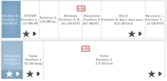

This pc started as my first Ubuntu daily driver when I transitioned from Windows, it's a dual-boot UEFI 64-bit system with Windows 8 (original system) and Ubuntu 18.04.5. Secure Boot is disabled.
Here is the current partition setup for the 2 disks.

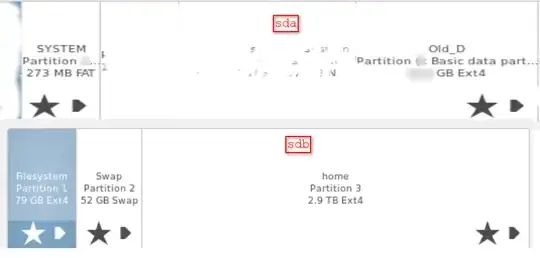

I haven't booted it into Windows for three or four years now, and sda is showing some issues on SMART, so it's time to replace it. I'd like to get rid of Windows in the same operation. Here's my proposed final config.
So, how to get from "current" to "final"? Here is my plan, asking if it won't work and how to fix the plan if it's wrong.
