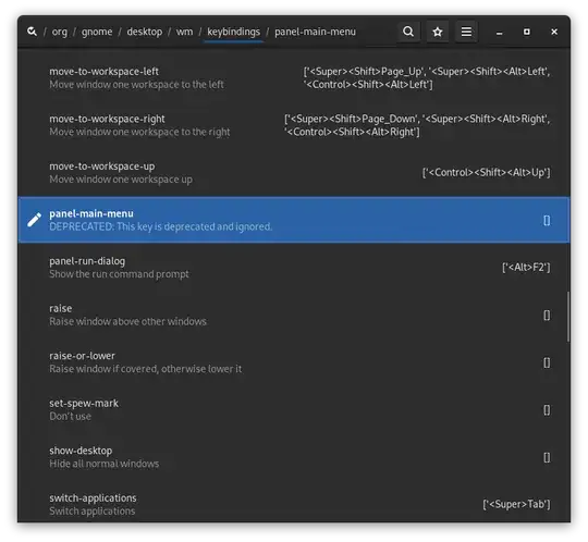

Instead of using gsettings, we can use UI: dconf-editor screenshot
The shortcuts are stored in /org/gnome/desktop/wm/keybindings/ path
Note how for /org/gnome/desktop/wm/keybindings/panel-main-menu it says
DEPRECATED: This key is deprecated and ignored.
Indeed clearing Alt+F1 using either gsettings set org.gnome.desktop.wm.keybindings panel-main-menu "[]" or by editing /org/gnome/desktop/wm/keybindings/panel-main-menu in dconf-editor no longer works.

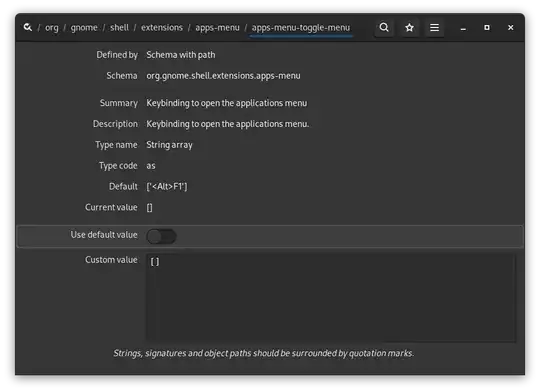

The setting now lives in /org/gnome/shell/extensions/apps-menu/apps-menu-toggle-menu in dconf-editor, changing it there to [] fixed it for me: screenshot
Or you can disable it using gsettings:
gsettings set org.gnome.shell.extensions.apps-menu apps-menu-toggle-menu "[]"
