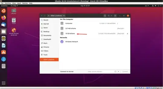

I wanted to write this as a comment, but it's just too long. This presumes that you didn't wipe the partition during the install/upgrade and that it's still there. This presumes that you just updated/upgraded and didn't choose the format partition(s) option.
The following also presumes that you installed in a normal fashion and that you made no drastic changes to how your system operates.
Assuming all those are true...
  1. Boot to your live instance as you're already able to.
  2. Open "Files" from the dock on the left.
  3. Click on "Other Places" (in the left sidebar of Files).
  4. Find your hard drive. This may take a few guesses. It will be one of the larger partitions, more likely than not. It'd look a bit like this: find your drive

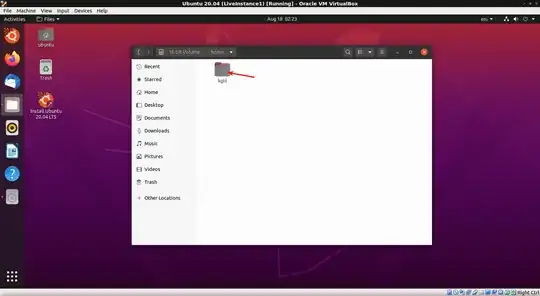

  5. When you find your drive/partition, find the /home directory and open it.
  6. Inside that directory, you'll find one more. THAT folder should be named the same name as your username. It looks like this: find your /home directory
If my images don't make sense due to the size, that's because I used a VM that's already installed and then booted to the live instance of Ubuntu over it. Thus it looks like my HDD is 10 gb, which it virtually is. Obviously, your username will be whatever you named it.
