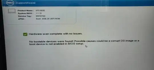

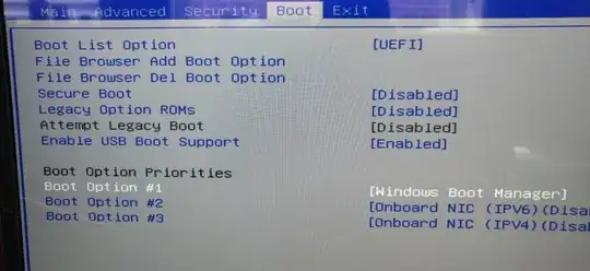

I followed this to remove Ubuntu 20.4.1 LTS and grub2 - the answer with the most upvotes. After that grub2 black screen is gone but Windows 10 is not booting. This is my Windows PC BIOS and this is the BIOS error message after Dell diagnostics is done

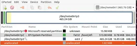

Here is the gparted view from my Ubuntu Linux 20.4 LTS enter image description here
There is somehow hidden Ubuntu 20.4 LTS being installed some where else also which is making my grub to boot into Ubuntu 20.4 LTS Linux.

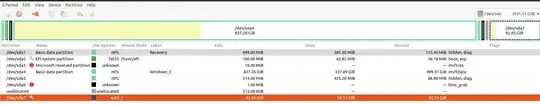

Update 2 After some more searching and digging, found that another copy of Ubuntu Linxu 20.4.1 LTS is installed on /dev/sda7 enter image description here
and also confirmed by df command

After that installed Ubuntu 20.4.1 LTS alongside Windows 10 on my PCI NVME hard drive. Live USB was created to boot into UEFI mode and BIOS was with UEFI(disabled Legacy mode and secure boot also disabled). Ubuntu Installation was totally smooth - everything running fine now.
