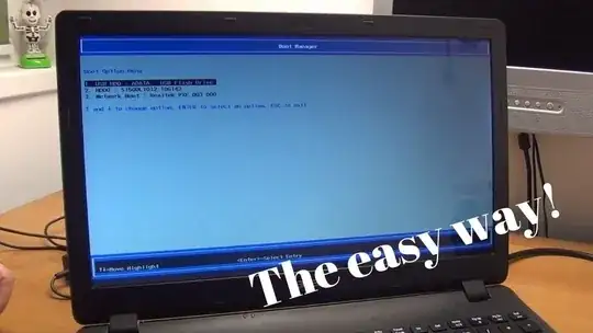

        Turn on your computer than Keep clicking escape untill it takes you to the menu then go to boot manager there will be windows and ubuntu, select ubuntu hit enter and it will boot ubuntu..
Go to the boot options and change the boot order and put ubuntu at the top, with the f5 and f6 keys..

        Try what Nmath said and after this check in your BIOS the Boot Order. Seems here is "Windows boot manager" selected. Check if you have other options to boot and use it for test. If you choose the right boot device, you will get the GRUB Menu every boot where you can choose what you want to boot.
