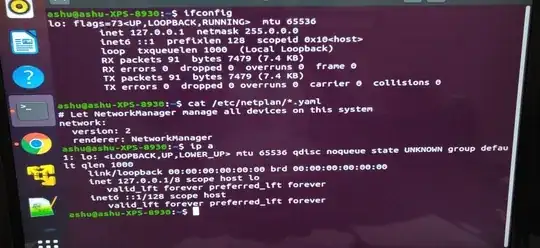

Output of ip a or ifconfig enter image description here

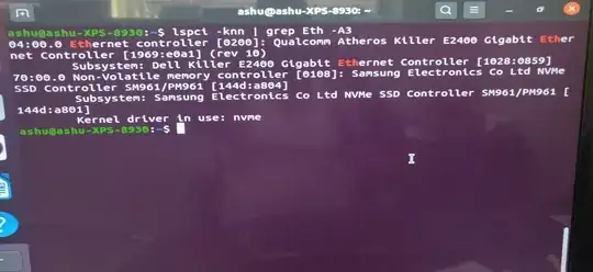

Output of lspci -knn | grep Eth -A3 enter image description here

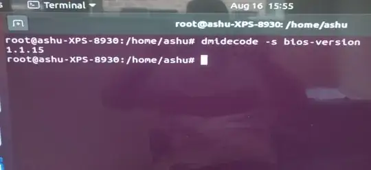

Output of sudo dmidecode -s bios-version enter image description here
