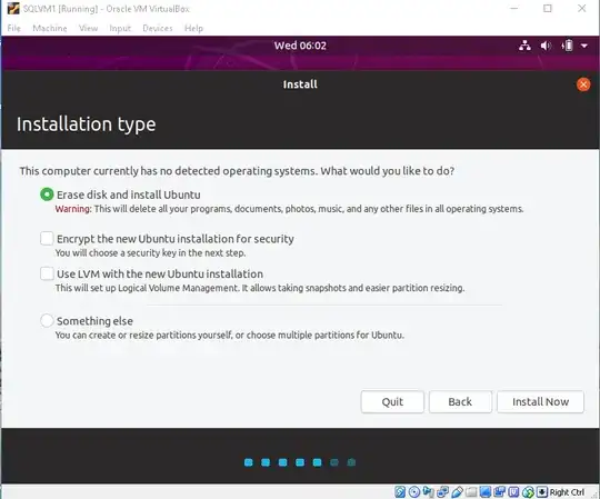

Everything seemed to work fine. I got to the installation prompt where it asks you the language you prefer, the network to connect to, etc. When I got to the installation type prompt here:
The prompt that I got to
I chose the first option to erase the disk and install Ubuntu. Yet again, everything seemed to go fine and after everything installed I was prompted to unplug the installation media (which I took to be my USB) and restart. After unplugging and restarting, the computer pretended as though nothing had installed and tried to install it again, giving me the exact same prompts from the first time I was booting it up. I went to the BIOS and made sure boot priority was given to my hard drive and no luck.
