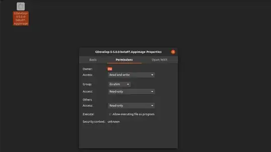

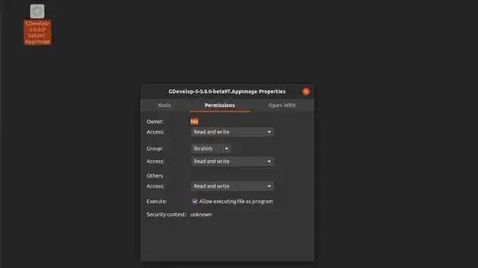

Right Click On The Appimage File And Go In Properties.
Then Go In Permissions.
Tick Allow Executing File As Program, and Both access : read and write, It must look the same as the image.
