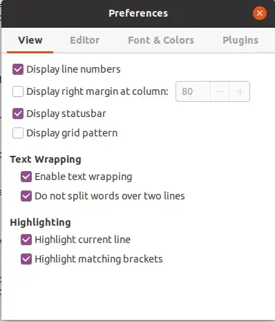

When I use gedit in Ubuntu 20.04, whenever I click on any of the checkboxes in Preferences, nothing happens.
Preferences
For example, when I click on Display line numbers, the checkbox is still marked as checked. For some reason, clicking Display grid pattern, Enable text wrapping, and Do not split words over two lines works, but when I exit out of Preferences and come back in, they go back to their original status, as shown in the picture.
All other options in other tabs can not be changed.
Edit: Apparently Preferences works when using gedit as a normal user, and not root. Previously, I was trying to change the Preferences as root
