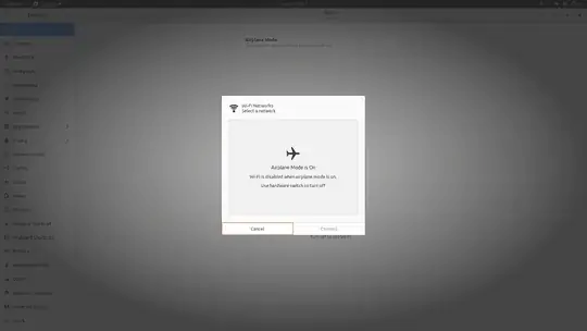

As soon as I close the screen,
Wifi gets disconnected
and if I try to reconnect it, it shows Hardware disabled error as shown below:
Image as shown below
I have tried the solution given in disabled by hardware switch but failed to resolve it.
The only option left with me is to reboot the system
Had the same problem, this has solved it: https://tipsonubuntu.com/2018/04/28/change-lid-close-action-ubuntu-18-04-lts/
sudo gedit /etc/systemd/logind.conf Finding HandleLidSwitch there and edit to: HandleLidSwitch=ignore

press f2 or any other key with airplane or signal symbol and try disabling auto disable wifi to save power from settings power
