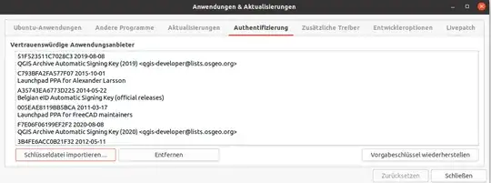

When looking at the list of authentifications, the key in question is there:
screenshot of the list of trustworthy keys - system doesn't allow me to embed pictures
What can be the problem?

On my system it says:
gpg: keyring '/etc/apt/trusted.gpg.d/qgis-archive.gpg' created
gpg: key F7E06F06199EF2F2: 1 signature not checked due to a missing key
gpg: key F7E06F06199EF2F2: public key "QGIS Archive Automatic Signing Key (2020) <qgis-developer@lists.osgeo.org>" imported
gpg: Total number processed: 1
gpg:               imported: 1
gpg: no ultimately trusted keys found
But with the following lines in my /etc/apt/sources.list:
deb [arch=amd64] https://qgis.org/ubuntu focal main # disabled on upgrade to focal
deb-src https://qgis.org/ubuntu focal main # disabled on upgrade to focal
QGIS installs fine using sudo apt install qgis giving version 3.14.1
