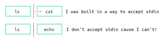

The easiest way that I can demonstrate it:
Some commands are built to accept stdin. Take cat as an example. You can pipe the output of previews command to cat:
$ echo hi | cat
Some commands only get arguments as input, for example echo. If you run:
$ ls | echo
It would pipe the output of ls to echo. But echo won't receive it. To use echo you have to give it some arguments:
$ echo "I'm an argument"
If you need to use a command's output as an argument to some other command (For example in a case when it only accepts arguments and not stdin), you have different choices. One is to use command substitution:
$ echo $(ls)
In this case ls would run then the output of ls would be passed as arguments to the echo.
Same for basename. You have to pass arguments.
Also there are commands which are able to take argument and stdin at the same time. For example cat. If you pipe something to cat it would print it out. However for an argument it except you to pass a filename to prints its contents out.
