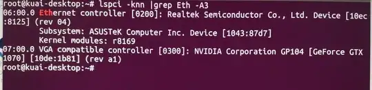

My desktop experienced hardware failure and black out, after changing the hardware, the system works, however, it fails to connect to the internet (ethernet), so I want to reinstall the internet module through dpkg, does any know which packages should I install via dpkg?
I tried:
$sudo lshw -C network
*-network UNCLAIMED
I also triedifconfig -a and basically it only returns info of inet 127.0.0.1
Edit: The output of lspci -knn | grep Eth -A3 (sorry for the picture cuz there is no internet) enter image description here
